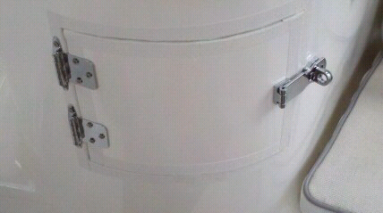

I think Bruce is referring to something similar to what I did in my cockpit to make an extra locker. The door is the same piece I cut out:

Minmax, what's the trim you user around you cut hole? Thanks.
I think the trim can be purchased at Home Depot or Lowes look in the bathroom cabinet area.
You have to make sure your cut is almost perfect or it won't work.
Wow, I missed your question. Sorry for the delay in my response!
I couldn't find any trim that would fit so I used white non-skid tape! It worked well, didn't it? :-)
