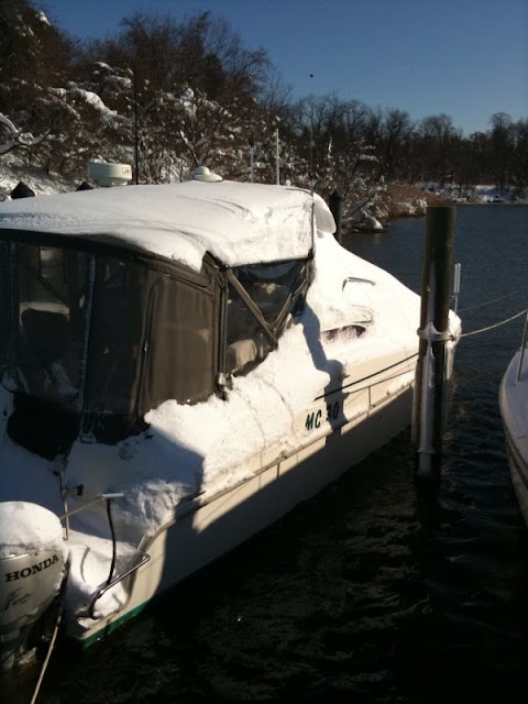

Isn't CA one of the states with the biggest boat claims due to freezing? It's either CA or GA if I remember correctly. I guess boaters there need to either leave the boats in the water or go through a winterization process like cold regions do. I leave mine in the water in MD all winter. A couple of bilge heaters keep things easily above freezing that way, even through our 90-some inches of snow last year:
Burrrrr. A boat covered with snow looks so COLD!!!! Maybe high number of claims is why insurance refuses to cover the damage......
