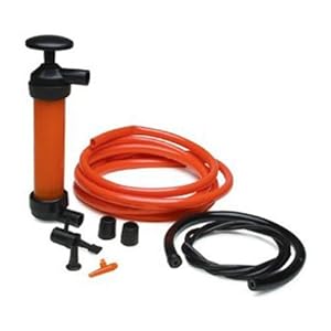

Wal-Mart carries this Penzoil pump in the automotive section for about $10. I used to use it before I started heating my waste area (with an Xtreme bilge heater). I also used to run 2 or 3 cycles on the Electro Scan without adding any new waste to it. This really made what's in there much less offensive.
Kurt, great idea. I also did run the cycle a few times before I went on the hard. I bet my local Tractor Supply might have that pump.
