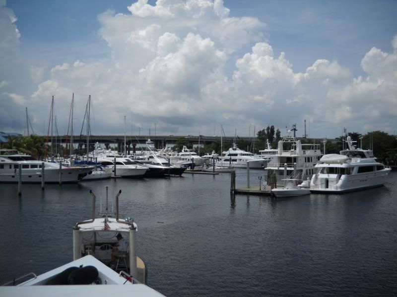

Moving day. Or, "Up the river without a diesel, or two".
Hooking up the aft tow boat.
The 180 deg. bend at "Little Florida".
Almost there.
Made it.
