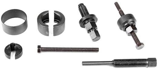

Hy is correct. It's a GM auto/truck pump, probably a "Saginaw." Pulley removal requires a special tool. I have one from Snap-On that's the three pieces in the upper left. The rest of the picture is the Pulley Installer part of the kit.
Usually a reman pump comes with the "installer" which in that case bears on a simple thick washer instead of a special ball bearing. Harder to use but works fine if you start and keep the press-fit pulley hub straight on the pump shaft. NO BEATING!!!
