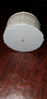

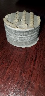

I am thinking remove a section at a time overlapping when the next section is installed. Maybe that way the crown can be maintained? If you are going to stop after the helm seat then seal up all of the screws that hold things down. I won't hawk coosa again except to show you what I wound up with. This is 1.25 thick. Three layers of Coosa Bluewater with thickened epoxy in between. Two layers of glass under it all AFTER I pressed the coosa up into the ceiling of the anchor locker overlapping several sections of 3 layers. The obvious unpressed glue is where the windlass axel came through the deck. I am thinking if you work from the top it would be a tough call to get anything in and somewhat curved without kerf cuts.

Bob keep in mind I was working with some room under the deck and was able to press it up in sections (see the earlier posts). Pushing it down into a flimsy layer of glass that is not supported could lead to a really wavy nasty result. I will say that core sample is representative of what was under a full on Gally Maid windlass when I was done, that weighs a ton.
