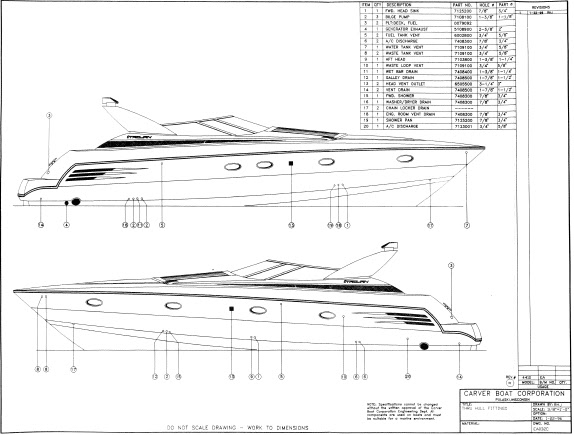

My next project is to rebuild the anchor roller shelf like John did in previous posts. Also, I need to figure out drainage for the anchor locker. There was a discussion in the past about weep holes. For the life of me I can find no evidence of any. Mine's a '98, and I'm not sure if anyone else's is like mine, but the fresh water fill hose from the deck plate runs right through the bottom of the anchor locker. I think I know now why there are no weep holes...cuz the damn water runs right through the fresh water fill hose hole in the anchor locker floor and goes right into the bilge! Which really sucks since I'm trying to find ways to eliminate water in the forward bilge, not encourage it!

Hi John. If I remember correctly there was a through hull at the base of the chain locker. I believe mine was plugged with debris. Water would back up down there and then drain into the center bilge. In heavy rain the water could not drain past the anchor roller fast enough either and would back up and overflow to the chain locker too. It was really evident once everything was repaired and put back. I cleared the hole down there so it could drain. I had planned to fix the drainage by the roller by putting a hole through the shelf at the front and when I put the roller back in use a washer between the roller and the base to let water under the roller and through the hole to the chain locker. I never got to that before selling the boat though.

Thanks John, I will go look again. I've got the anchor locker very clean and I don't see any drainage, other than the hole that the fresh water fill hose goes through at the very bottom of the anchor locker, which is the opposite of where I want the water to go. I want it to go OUTSIDE the boat!!

I used to have some drawings that showed it on my blog. I will see if I can find them tomorrow. Or a better picture. I had to re-subscribe (and pay) to get my pictures from photobucket but I will look there too. Maybe yours did not come with one. I have found differences boat to boat even in the same model years.
